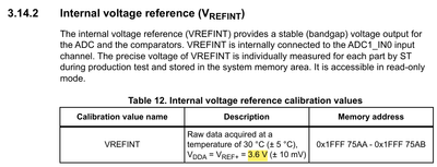

Your math isn't checking out:
> #define VDDA_CALIB 3.0f // Reference VDDA voltage in volts
> uint16_t vrefint_cal = *VREFINT_CAL_ADDR; //1374
> printf("VREF_ADC: %lu, TEMP_ADC: %lu\r\n", vref_adc, temp_adc); //1491 946
> float vdda = (float)vrefint_cal * VDDA_CALIB / vref_adc;//3.16634059
But if I use the values you state in the comments, I get this:
vdda = 1374 * 3.0 / 1491 = 2.76
Datasheet says it was taken at 3.6V, so:
vdda = 1374 * 3.6 / 1491 = 3.31
which seems more reasonable. I believe VDDA is 3.3V on that board. If you use that value, you get a reasonable temperature (> 30) with your calculations.
*The datasheet may have a typo here. It was probably read at 3.0 V, not 3.6 V.
