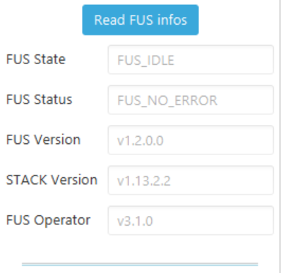

However, after upgrading the stack using STM32 CubeProgrammer, P-NUCLEO-WB55RG cannot be found in ST BLE ToolBox.
The picture below is the stack information at the time it was initially received, and the following picture is the stack information I updated.
<default stack - work ble >
<updated stack - do not work ble>

2022-03-25 3:36 AM
Values look OK.
Could you provide us the values of the SFSA and SBRV option bytes?
My suspicion is on the wireles stack that may have been erased.
2022-03-25 7:38 PM
Hello, thanks for your reply. This problem is resolved.
After stack update, start the stack via SWD CLI. then it's resolved.
