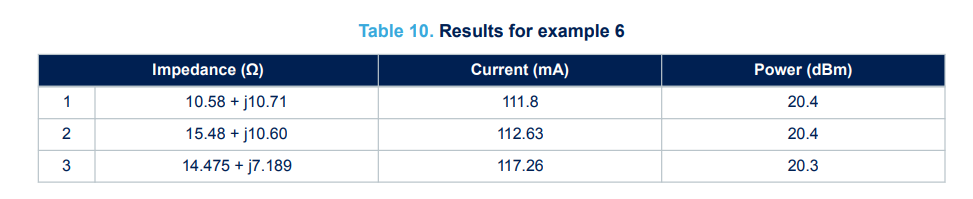

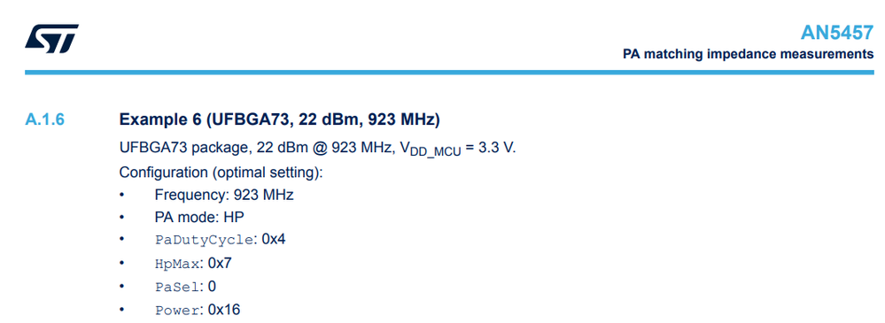

The AN5457 provides the example for 923MHz network. (A.1.6)
I can get output Impedance from this example(AN5457).
