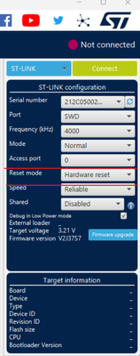

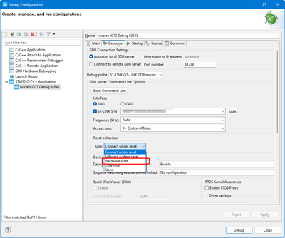

2024-01-31 5:03 AM
The ST-Link should be able to assert the NRST line.
Did you have the ST-Link configured to do a hardware reset?
2024-01-31 5:12 AM
Hey Andrew Neil,
@Andrew Neil wrote:The ST-Link should be able to assert the NRST line.
Yes, I have configured the hardware reset from the debug configuration, I have also tried hardware reset and other options from STM32CubeProgrammer options, but it didn't work.
