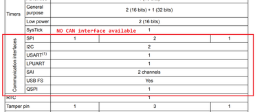

But STM32WB55 device has no CAN interface. How are you receiving CAN frames with it?

2025-01-15 5:23 AM
Thank you for your response. The CAN bus data is being collected via a MCP2515-I/ML and MCP2562T-E_MF. I'm receiving the CAN bus data correctly. Just can't figure out the best way to transfer that data to the BLE stack to be sent. I'm using the default sequencer from the P2P_Server/Client applications.

Now it's clear.
MCP2515: CAN controller over SPI.
MCP2562: is the CAN transceiver.
So your question is about MCP2515 SPI throughput versus the Bluetooth. The interface having the less throughput will be the bottleneck + How CPU will be able to handle that transfer based on that throughput (maybe using DMA?). I'm not expert of wireless but I think what you need to care of, is to manage the double/multiple buffering data transfer between SPI and Bluetooth.
