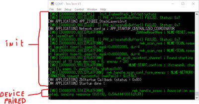

I am working on a Zigbee project for my school and i have never worked with any form of wireless communication. I managed to flash the Zigbee_OnOff_Server_Coord application on my nucleo board and the Zigbee_OnOff_Client_Router on my USB dongle. And when i click on the dongle button the led on the nucleo toggles, that alone works just fine.
But for my project i need to connect an Aqara Door and Window Sensor to my P-NUCLEO-WB55. When i click on the "pairing" button on my sensor even tho i am able to connect it with the nucleo i have no idea on what to do after that, because when i toggle the door sensor state (manually open/close the sensor) nothing appears on the terminal.
