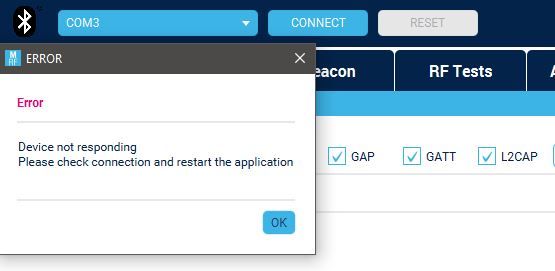

I want to connect to the WB55 USB Dongle with CubeMonitor-RF to scan for my BLE peripherals.
I followed the connection guide and flashed the BLE_TransparentModeVCP firmware to the dongle. I also installed the VCP driver under windows. The dongle appears as "STMicroelectronics Virtual COM Port (COM3)" in the device manager.
But it still is not responding to a connection request from the CubeMonitor.
Is there anything left I could have forgotten to do or set up? Do you have any advice how I will be able to finally connect to the USB dongle?

Hello @Richard.Chvr ,
unfortunatly there is no log message. When the error popup appears, the log is still empty. And when I click OK, the CubeMonitor closes without any further display of information.
