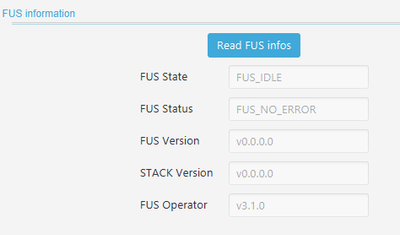

1) No RDP :
No write protection (I think) :

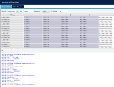

2) Perform a mass erase :

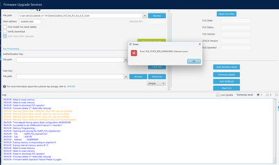

3) Trying to delete radio firmware :
And got an error...
Any other clue ?
2024-06-11 3:35 AM
thank you for posting pictures showing your steps. The last one with error shows also the log. From the log I can see operations fails, when STM32CubeProgrammer is erasing first two sectors (8 kB starting 0x08000000) to load FUS operator, but erase of those 2 sectors fails. Also before that is in log "failed to erase memory", but not visible to which commands it's tight.
This is typically issue with write protection, which you show is not enabled. Could you please verify write protection is not active?
Please check PCROP as well.
Please ensure your option bytes setting is correctly written in MCU. When you do power cycle (disconnect and connect USB cable), can you still see the same content?
When not successful, please post post also picture with Security Configuration Option bytes - 2.
