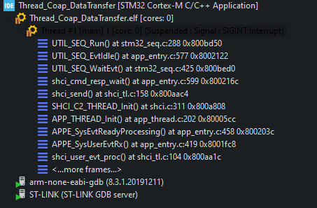

Now, when I run the program, it looks like function SHCI_C2_THREAD_Init() never returns, as shown in the picture attached:I connected to the UART to get the trace debug output, shown below:

I not sure where to start here: the microcontroller, crystals, passive components are all the same as the Nucleo board, for which the same exact program runs without issues.
Additionally, the option bytes are the exact same.
Do you have any insight on what could be causing this issue?

Turned out my issue was a hardware one: my external crystal footprint had the wrong pinout, and it looks like CPU2 needs the HSE to start the FW stack, After fixing the crystal, everything worked as expected.
