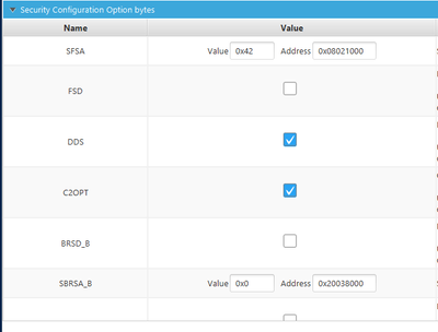

Dear @GRama.2,
Many thanks for the info.
Please, can you share Option Bytes values of your Nucleo dongle?
Specially SFSA, FSD, C2OPT, SBRV (in "Security Configuration Option bytes") and ESE.
It will give us an idea of how the device is configured.
Best Regards,
Alan Porte
ST MCU Support Team
Alan
ESE  -  checked
SFSA  Value=0xF6, Address = 0x080F6000
FSD  -  unchecked
C2OPT - Checked
DDS - Checked
NBRSD Unchecked
SNBRSA: Value=0x19, Addr = 0x2003C000
BRSD - Checked
SBRSA  - Value=0x0, Addr = 0x20030000
SBRV Value=0x3D800, Addr = 0x003D80
Thank you.
Giri
