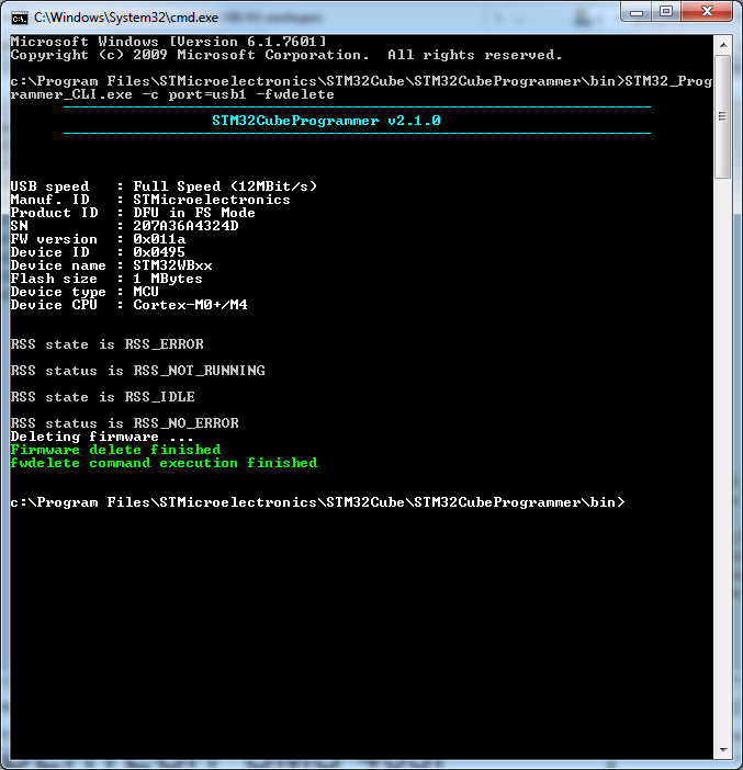

Hi! I got same issue today. After removing old coprocessor FW i was not able to detect board by USB in DFU mode. I have custom board. Port LPUART was connected via USB-serial to the PC.
I have removed FW without any issues:
But after that - i was receiving message - USB device not detected.
I made next steps and board was able to be detected via USB:
1 - Erased FLASH in normal mode;
2 - Erased FLASH, sector by sector after booting in DFU mode (with boot0 signal)
3 - Disconnect USB-Serial port, connected to the PC.
Now board works OK! Hope this post helps you.
