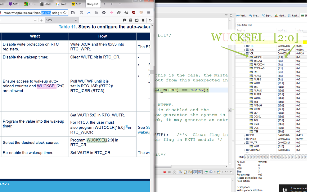

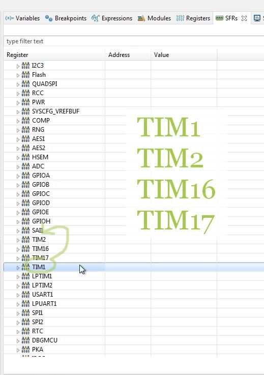

I check for TIM17. SVD files by @Imen Ezzine is correct. But in 1.9.0 pack there are old SVD files.
@Christophe Arnal

2021-11-09 8:14 AM
Also check RTC registers!
