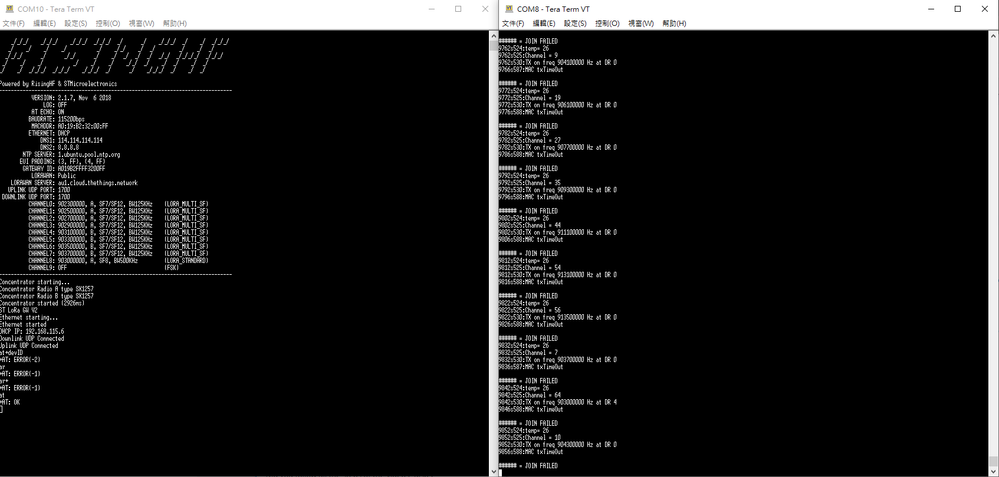

I use End-Node example code in I-Cube-LRWAN software to run I-Nucleo-LRWAN1, but my device always say join fail.
I learn to this video step by step do, but also not work.
Conld anyone can help me? Thank you.
Update 2021/11/12
The End-Node example code in I-Cube-LRWAN is not for I-Nucleo-LRWAN expansion board. It's for SX1272MB2DAS expansion board. So if you use I-Nucleo-LRWAN expansion board you only can use LoRaWAN_AT_Master example code in I-Cube-LRWAN.

There could be multiple reasons for that...
Do you see JOIN packet being catch by the gateway ?
Are you using I-Nucleo-LRWAN1 together with the pack P-NUCLEO-LRWAN2 ?
Did you follow all the steps of the video 2 also ?
2021-11-09 4:42 AM
I see join fail in I-Nucleo-LRWAN1
Yes.
Yes.
