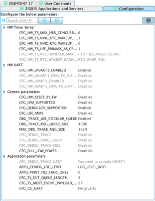

Heres screenshots of the CubeMX configuration:

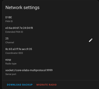

And here's a screenshot of my network settings in ZHA (I don't know if this helps):
