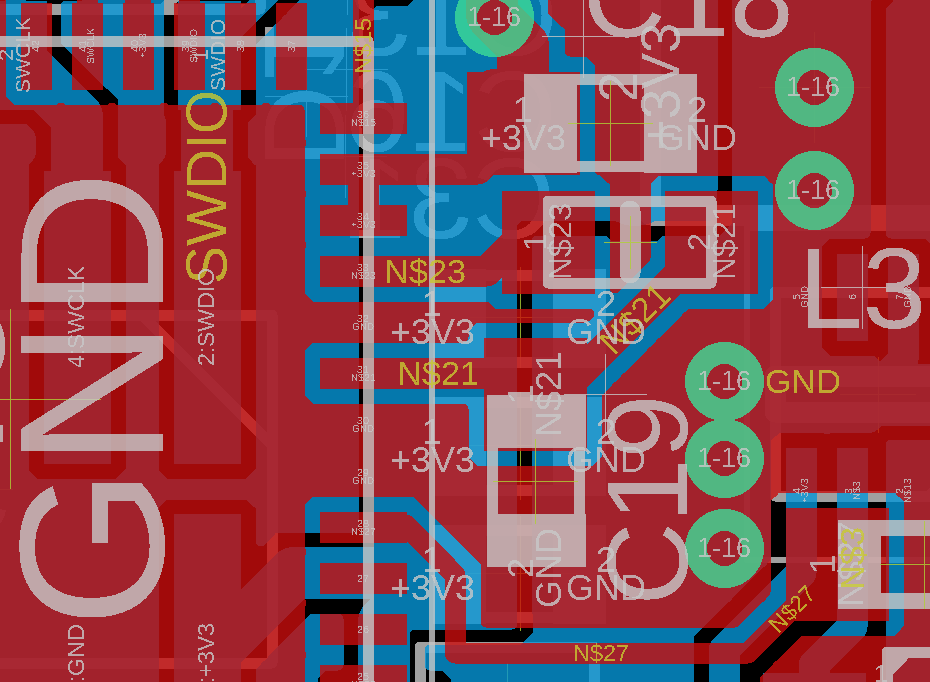

Just what i expected happened. I supplied the pcb with a normal external lab supply, current flickered from 100mA to 200mA, µC side at the area around pins 31,32,33,34 (C18=C19=4,7µF,L3=10µH) got pretty warm, then went into a short ciruit and the controller waved goodbye with a heap of smoke. :sad_but_relieved_face:
Now that i checked, the SMPS GND (pin32) is poorly connected, it just goes over the exposed pad, so that the SMPS current has to go an unnecessary long way, which might cause the issue.
