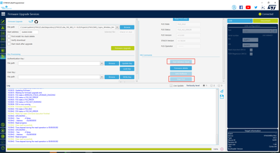

When I burned the Bluetooth protocol stack onto the new chip, my code was not executed efficiently and the Bluetooth broadcast was not enabled. I checked the documentation and found that the protocol stack needs to be started, but the corresponding buttons in my STM32Programmer are greyed out. I would like to know how to solve this problem.

Could you please try to update the stack using the last version.available on the STM32CubeWB V1.21.0 and using the last version of the STM32CubeProgrammer 2.18.0.

Thanks! ,After updating to STM32CubeProgrammer 2.18.0, it works.
