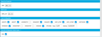

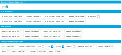

When reading the option bytes:
I tried in PRG to write the IWDGSTBY and IWDGSTOP bits, that worked. RDP = AA, PCROP and Write protect seem on first sight ok. ESE is not possible to set/reset. (Like not present).

seems you were trying to change make flash operation (write/erase) or make OB change and get reset or power glitch. As mentioned in documentation STM32WB option bytes content may get broken during such situation. Flash write/erase and OB change shall be avoided in situation, where is risk to get reset or power down.
You may try to follow steps mentioned in AN5185 (page 10) to restore your MCU.
Concretely:
connect your board to your PC and using STM32CubeProgrammer
1) set OB to boot in System Flash (nBoot0 = 0)
2) reboot
3) connect STM32CubeProgrammer with hotpug mode, SWD still to be used
4) start CPU2 using write 0x00008000 at 0x5800040C (disconnection shall be triggered automatically)
Now you shall observe option bytes is in default setting SFSA = 0xF4, SBRV = 0x3D.
Due to security reason it's not allowed to remove security from CPU1, only CPU2 is allowed to access security related OBs.
Please let me know if working for you.
