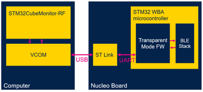

My understanding is that I can use the Transparent mode to cummunicate with an another STM32 via UART (as explain in AN5289 8.1.2 and shown in the image above).
If so, I am able to send data to the STM32WB from a STM32L4 via LPUART.
You say that I need to click on "start advertising" on STM32CubeMonitorRF. So, does it means that even if I don't use STM32CubeMonitorRF I need to send a command (with HCI?) to start the advertising?
