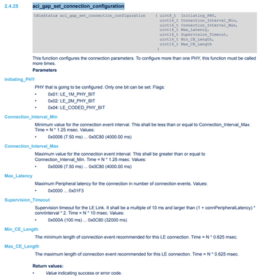

} As per AN6142 the maximum value configurable on this call, for "Connection_Interval_Min" and "Connection_Interval_Max" is 0x0C80 (corresponding to 4s).
Even by setting raw values on the aci_gap_set_connection_configuration, nothing changes as i always get correct return values (0x00) ;however the next call which is to aci_gap_start_procedure failed with return code 0x12.

If connection interval is changed, supervision timeout may also need to be changed. This is the description of Supervision_Timeout: The Supervision_Timeout in milliseconds shall be larger than (1 + Max_Latency) × Connection_Interval_Max × 2, where Connection_Interval_Max is given in milliseconds.
So, to be able to attend the maximum level of the Connection_Interval_Max, you need to set the Supervision_Timeout to the maximum value as indicated on the chapter 2.4.26 of the AN6182.
