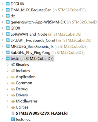

Hello @drafshin
I've added a project that does compile on the STM32CubeIDE V1.17.0. Please open it as it is or generate your own based on the .ioc file of this project (don't change parameters). After that create another project (any project on any MCU not the STM32WB0) I've got already other projects on my side too:
After that compile the project based on the STME32WB0. You may receive another message. After that compile the other project and recompile your STM32WB0 project. This time it should be working fine with this workaround:
PS: this behavior will be solved on the coming release (coming in a few days) of the STM32CubeMX.
Best Regards.
STTwo-32

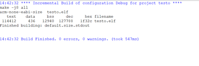

2025-02-15 4:21 PM - edited 2025-02-15 4:22 PM
Sorry for late reply, I got another project and couldn't try your code erlier.
I followed your suggestions and did the followings
1. Downloaded the project you attached and opened it in CubeIDE
2. create a project for a STM32F07 and copied. a simple serial, and built it
3. I built the project you provided. (I had to clean to remove a cash error, for future people want to try this)
and I think it worked! I got only the following error but hex generated.
C:/ST/STM32CubeIDE_1.16.1/STM32CubeIDE/plugins/com.st.stm32cube.ide.mcu.externaltools.gnu-tools-for-stm32.12.3.rel1.win32_1.1.0.202410251130/tools/bin/../lib/gcc/arm-none-eabi/12.3.1/../../../../arm-none-eabi/bin/ld.exe: NOTE: This behaviour is deprecated and will be removed in a future version of the linker
Thank you for the help
