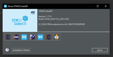

First, try using the STM32XCubeIDE V1.17.0.
Best Regards.
STTwo-32
2025-02-11 6:29 AM
Looks like you found another bug with ST cube, I am using 1.17.0. I initially installed 1.16.1 but then I used update feature of the cube an d updated the software, and I never created any project with 1.16. is this another bug with the ST cube?
2025-02-11 6:38 AM
Hello @drafshin
There is not any issue on that. You are just using the same repositories for both versions. The first behavior should be solved on the Future.
Best Regards.
STTwo-32
2025-02-11 1:52 PM
Thank you, so the log showing 16.1 is not an issue?
until new software releases how can I create an BLE application with this chip? I followed your steps and it did not lead to a error free compilation.

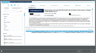

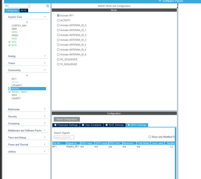

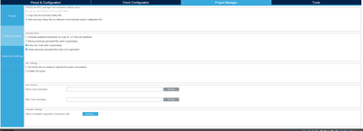

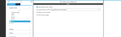

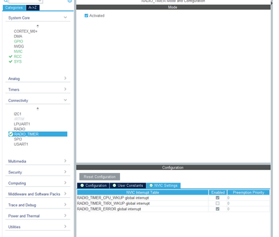

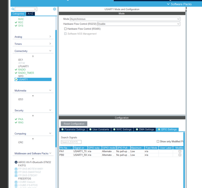

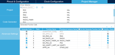

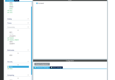

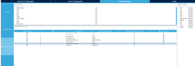

Thank you for the help,

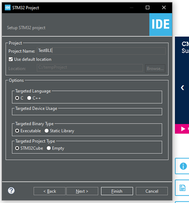

Here I am going to create one blank BLE project and screenshot all process
1. Creating a temp project, selecting the target microcontroller (STM32WB05KZV6TR)
2. Selecting C, and hitting yes for opening the configuration tool
3. Enable the HSE
4. enable the Radio timer

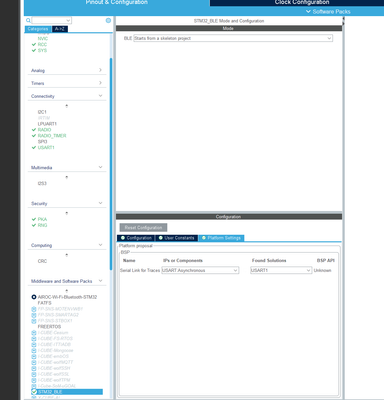

5. Enable the radio

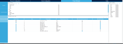

6. Enable the PKA and RNG
7. enable USART
8. enable BLE and add USART as platform for traces

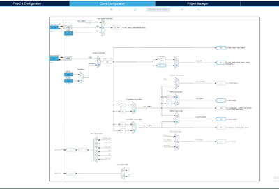

9. Clock configuration

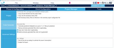

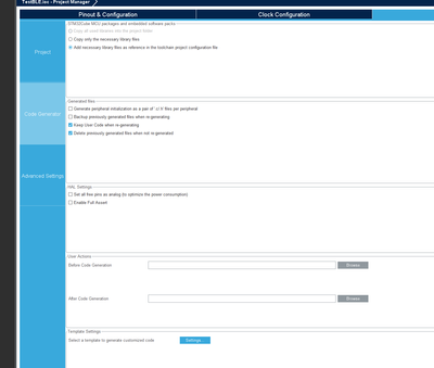

10. add files to the project
11. advanced settings as suggested
12. save and generate code
13. press compile
14. get error
