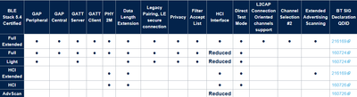

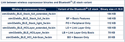

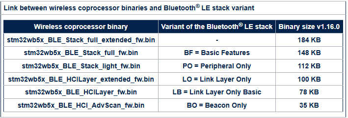

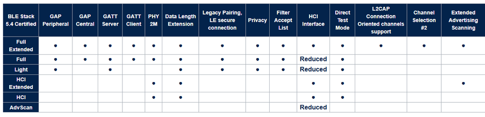

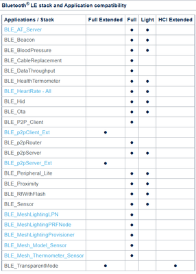

2025-05-13 2:01 AM
Hello @dxxx0001,
Refer Below images which I found in STMicroelectronics Official Documents as per this tables you will able to identify which BLE stack required.
