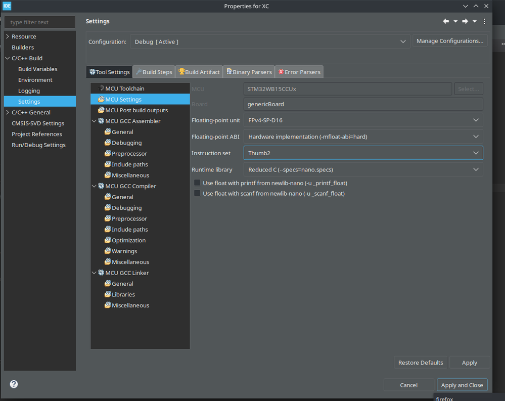

I did stop the debugger multiple times, but no error handler was triggered, and the code seems to run nominally.
I also have similar this kind of issue when enabling the flag to print float in string using sprintf.
I use a wb15cc I think it has a m4 for the BLE part. I will have a look to the FPU. I didn't know it needs to be enabled
2023-02-25 12:39 AM
I checked the FPU the hardware one is enabled by default. I tried the software one but doesn't work either. It seems that there is a mismatch between the RF Core and the Application Core. Is the Stack binary compiled with floating point flag? Actually my app is running by it doesn't tell the wireless stack to start advertising.

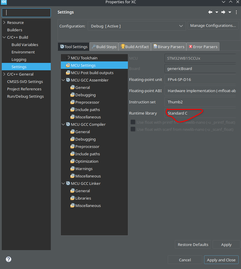

After sime further try and error I could run the advertising and the FPU by setting the runtime library to standard C. The question now why is this so?
