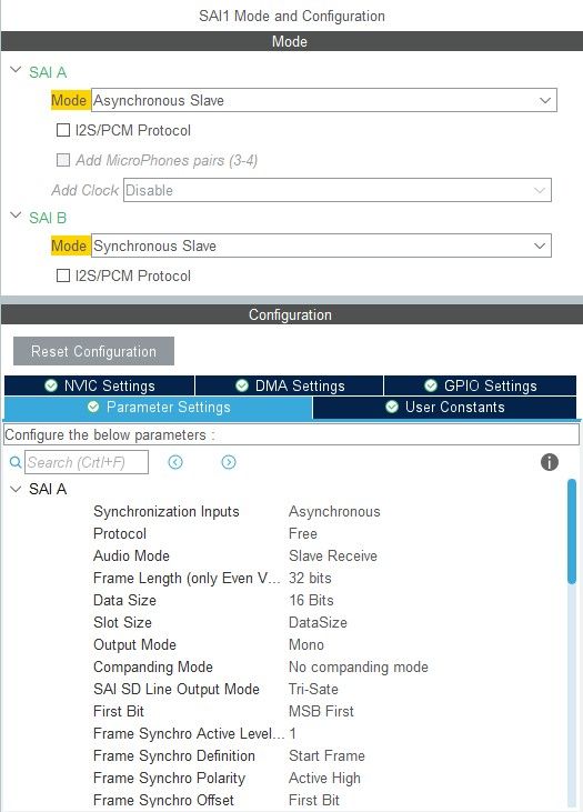

I found a possible bug in the "stm32wbxx_hal_msp.c" file when using Cube in the STM32CubeIDE to enable the SAI peripheral.
I did not test all the combinations, but have mine set up as follows:
SAI A - Async Slave
SAI B - Sync Slave
The bug is that the the code does not include and set the "Alternate" member of the GPOI_InitStruct for SAI Block A and B

Thanks for your preempt reply and for attaching your project. Actually you're right, I've been able to reproduce the issue using STM32WB35CEUxA MCU even with the latest STM32CubeMX version 6.3.0.
This misbehavior will be reported internally to be fixed. I'll keep you posted with the updates.

Actually, I wasn't able to reproduce any issue from my side, and GPIO_InitStruct.Alternate = GPIO_AF13_SAI1; is correctly generated.
Could you please attach your .ioc file for further check ?

Yes, every time CubeMX generates the code after a change, the GPIO_InitStruct.Alternate code is removed.
Unfortunately I cannot test it with version 6.3.0 just yet, since I'm in the middle of a project and don't want to update the software until we reach the next milestone.
I have attached the ioc file for you.
