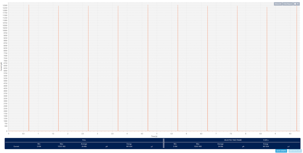

I'm attaching the Beacon example with stop mode enabled.
Please let me know if it works on your side, you can see the current consumption of this application below.
Also, before measurement please remove JP2 and everything from JP5.
Best regards,
Filip Kremen
