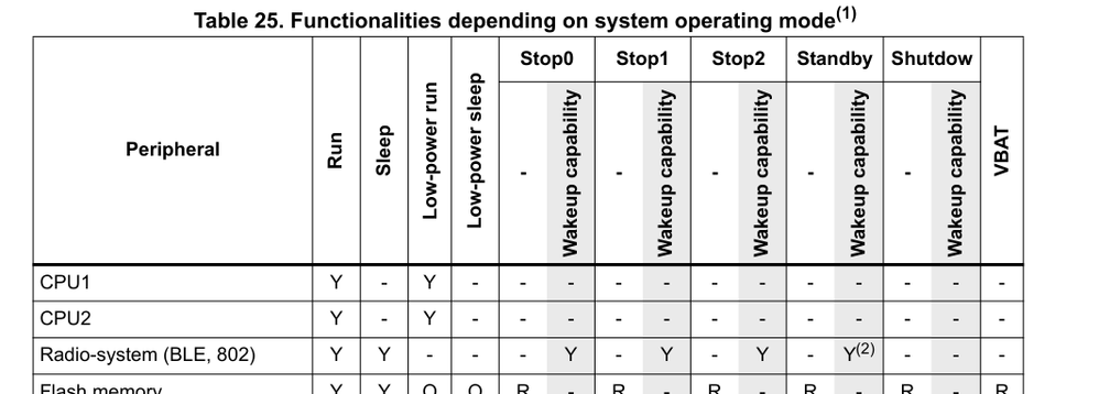

In RM0434, it is stated that the system will enter low-power mode only when all three subsystems allow it (CPU1, CPU2, Radio Subsystem). A few lines below, it says that these three subsystems can enter and exit low-power mode on their own (page 154).
At the same time, the table here shows that CPU2 cannot run in STOP mode, but the radio can wake up the entire system if needed.

1) You can put CPU1 into STOP2 mode while BLE advertising. The CPU2 and the radio will handle the BLE operations on their own.
2) If someone has already connected to your device via BLE, you can still put CPU1 into STOP2 mode. The CPU2 will manage the BLE connection and will wake up CPU1 when necessary.
3) You can refer to the PWR examples of the STM32CubeWB V1.20.0 for more details.

Thank you for the response. I probably have a hidden error somewhere, because when I start entering STOP2 mode, BLE starts to malfunction rather than work properly—connecting via BLE becomes nearly impossible. I have advertising set to around 100 ms, but in STOP2 mode, I see the period increase significantly to: 1.5 seconds, 4.56 seconds, and similar values. As far as I know, CPU2 (BLE stack) should handle this timing independently of the state of CPU1? @STTwo-32

CPU2 should handle all BLE functions and parameters for the integrated BLE.
