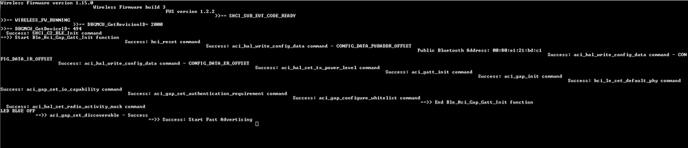

The example project BLE_p2pServer ishas the debug interface configurated such as it is possible to see what is happening on the Wireless Stack.
For example
However if I use the project IOC file to make a new project I'm not getting any information.
