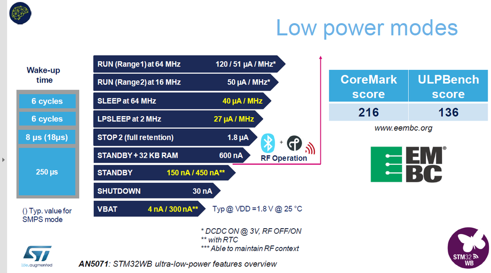

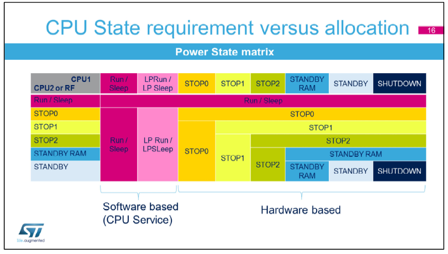

Yeah I did try the Stop2 mode. Works well. But i thought RF is possible is standby mode based on this slide.
And from this slide, I figured out I need to set the LPMS bit for CM0+ standby mode so that it will go into standby instead of only stop2.
Anyway, you are a great help man. Thanks so much.
Regards.
2019-04-11 10:07 AM
The STM32WB being a dual core MCU, it has to be perceived as a standalone MCU (CM4) + Radio(CM0+). Therefore the slides shows all the available power mode of the combo solution. This being said the current wireless firmware delivered on the radio CM0+ subsystem support low-power mode down to stop2 even if the MCU can go to lower power mode. In wireless use cases, the RF and CPUs activities are scheduled periodically so that the ratio between the active time and the idle time shows that the power saving between standby and stop2 is minor vs the benefit at application level to remain in stop2 (full ram retention, fast wake up time …). However we are very eager to learn more about your use case and the need of standby mode.
