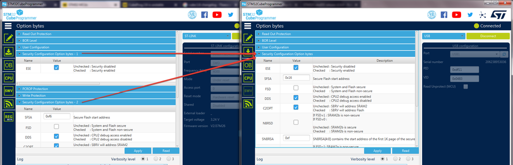

I use STM32CubeProg 1.6 to configure my stm32wb55. If I use ST-Link there are two bookmarks and if I use USB boot there is only one bookmark. Is it ok?

1) "or difference between Debug and Bootloader option bytes display , it's coming from a tool internal implementation detail which doesn't impact the final user.If you are facing any issue with that I can report it to Development team." I think it is not ok that in boot mode I see one set of bookmarks and in debug mode I see another set...

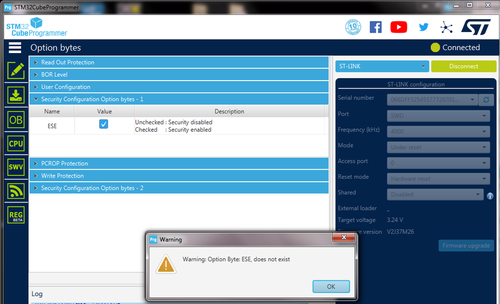

2) ok, in my case ESE bit is read only . So CubeProg should say "ESE bit is readonly in debug mode", but CubeProg says "ESE does not exist". It isn't the same.
