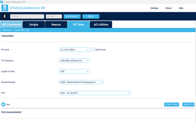

For the second question, if you are testing on a transmitter, you can set the PA Level you want here:
Best Regards.

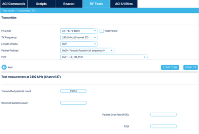

for "Get RSSI" means there is no solution to get the RSSI value ?
i do the some in mode transmission, i get the number of packets but there is no value for the rssi :
thanks
2025-03-12 3:34 AM - edited 2025-03-12 3:37 AM
For the STM32WB0, you can't get the RSSI using the STM32CubeMonitorRF.
