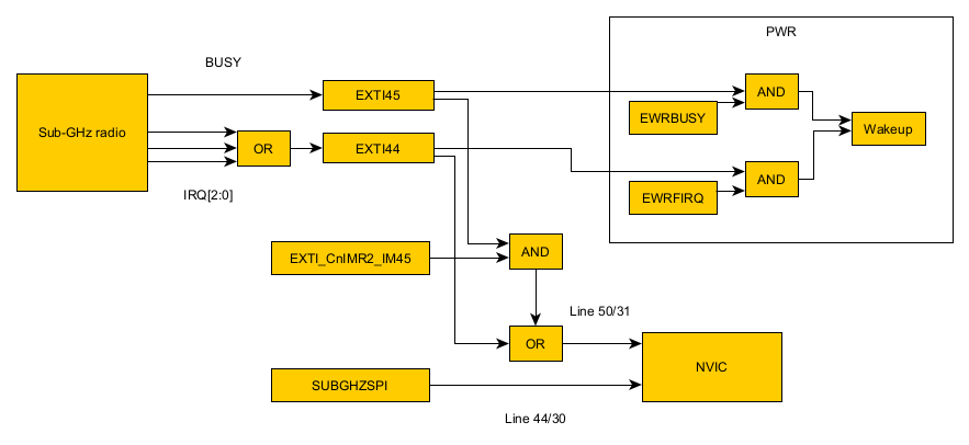

I'm having trouble understanding the radio IRQs on STM32WL55. According to the reference manual NVIC section, there is one interrupt line for two interrupt sources (which are ORed together) for the radio:
According to the EXTI section, the EXTI44 line is a "Direct" one and the "EXTI45" one is a "Configurable" one. This means the EXTI45 can be enabled/disabled via the EXTI_CnIMR2 and cleared via the EXTI_PR2 register. The EXTI44 signal however can not be masked or cleared via the EXTI's registers, correct?
Additionally, both EXTI44 and EXTI45 can be used to wake-up the CPUs from standby. This can be enabled via the EWRFIRQ/EWRBUSY bits in PWR_CR3 and PWR_C2CR3 registers. However, this wakeup does not cause an interrupt to be called, only a power-on of the CPU, correct? If the CPUs never enter standby mode, the EWRFIRQ/EWRBUSY bits have no effect, correct?

This means that the 3 radio IRQs can only be masked in the NVICs registers and via Cfg_DioIrq, correct?
There is also the SUBGHZSPI interrupt, but this is completely independent from this issue. So the complete SubGHZ interrupt structure looks like:
