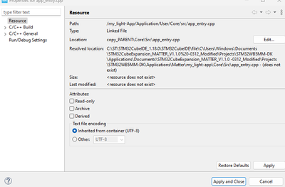

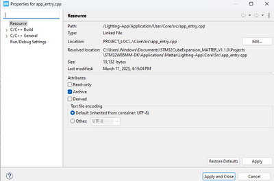

Yes I copy and paste the whole STM32CubeExpansion_Matter_V1.1.0 folder into my document folder from the download folder. One thing I noticed when comparing the project lighting-app project v.s the my_light-app project ( the difference is that I renamed the latter from the former in cube IDE) is that the location of each file is different. For example, the app_entry.cpp file in the lighting-app has the location of PROJECT_LOC\..... ; however app_entry.cpp in the renamed project ( my_light-app) has the location of copy_parent\Core\....
( I have included two screenshots of the location of the file below)
I tried to manually copy the file location of the not renamed ones to the file location of the renamed ones, and it seemed to work.
But is there a more efficient way to fix the problem instead of manually changing them one by one? As basically all the files in the project has the same problem.

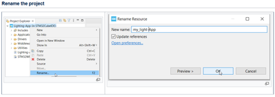

Did you check "Update references" when renaming the project through STM32CubeIDE ?
As explained in the Wiki Page you have to copy the template project in the same location \Projects\STM32WB5MM-DK\Applications\Matter\ and rename it to "my_light-app", then you have to open the project with STM32CubeIDE and rename it as follow :
This allows to update all references and makes the links properly.
Please restart with new project to check this.

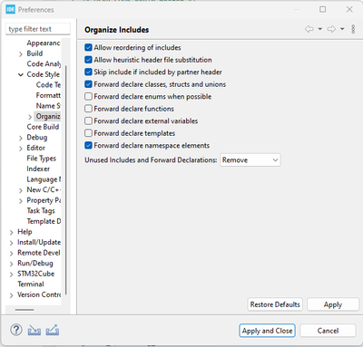

I was using the previous version v1.1.0, therefore I copy my template project to that location. Here is my address of the my_light-app: C:\Users\Windows\Documents\STM32CubeExpansion_MATTER_V1.1.0 -0312_Modified\Projects\STM32WB5MM-DK\Applications\Matter
I also did rename it with update reference checked. Maybe it's the preference in the update reference that is difference?
Below is my preference for the update reference.
Thanks
Brady
