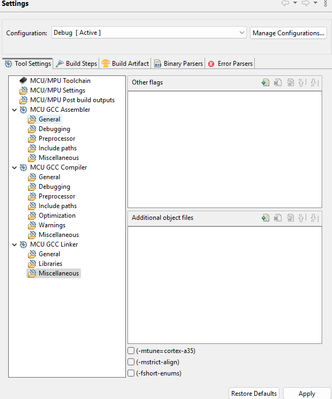

this pointed me in the right direction.
adding
-Wl,--defsym=DEBUG=1to the build spec under MCU GCC Linker -> MISC -> Other flags along with a check in the linker script
FLASH (rx) : ORIGIN = 0x08000000, LENGTH = DEFINED(DEBUG) ? 32K : 28Kproduces the expected result (-Wl is necessary to forward the --defsym statement to the linker)

I was thinking about passing a parameter to the linker (via the build spec settings in eclypse) to define a symbol that is then used in a DEFINED() statement. apparently flags can be passed to unset symbols but I have not found any to set symbols.
can you elaborate on your proposed solution? have you tried it yourself?

2025-09-08 6:49 PM - edited 2025-09-09 12:02 AM
Try the --defsym symbol=expression command line option.
Also, you can put definitions of symbols (symbol=value ....) in a file and pass it to linker via -T option, before the main link script. The link command can have multiple -T options.
