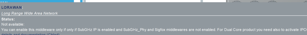

hello werewolf can you please share a tutorial on how this is done, i'm stucked on the dual core lorawan as well, im not even able to build , the middleware Lorawan is not available even thought IPPC is enable :dizzy_face:
2022-04-26 12:25 AM
Hey
You need to make sure that the SubGHZ and IPCC module are both enabled. Otherwise LoRaWAN is unavailable.
