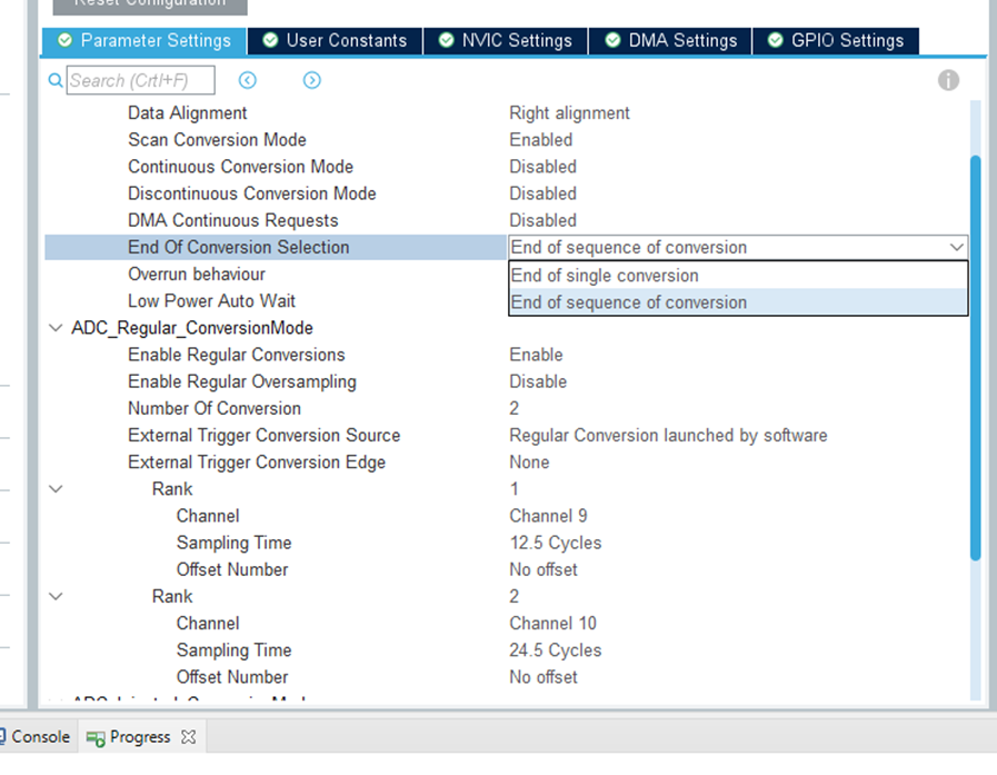

Good morning......
I am using the ADC with 2 channels (Ch 9 and Ch 10). I am using an LPTIM to take these samples every 15ms. I have the ADC callback (HAL_ADC_ConvCpltCallback) to interrupt on 'End of sequence of conversion' (per .ioc --- or so I think). Can someone tell me what registers in the ADC I should be looking at to find the analog values of the two channels? I am not using DMA and only see one DR (Data Register in the module). When doing more than one channel must I use DMA??
Thanks
Effectively, yes. Or interrupt and handle it before the next sample arrives.
2022-01-05 11:25 AM
So I am using interrupts.....I have multiple A/D channels selected (2) and SCAN mode enabled. I am using software to trigger the A/D. If I set End of Conversion selection to be 'End of Single Conversion' won't I go into the ISR to transfer the first value from the DR then because of scan mode (and maybe I have to set continuous mode here as well???) won't I then do another A/D sample without having to send another trigger and pop back into the ISR after that one has set the EOC flag? In effect I would then just capture DR in the next element of the array ......No DMA needs to be involved

2022-01-05 1:43 PM
See "Managing a sequence of conversions without using the DMA" in the reference manual.
I doubt 24.5 ADC cycles is enough to read the value in time to avoid the overrun. But it's possible. It doesn't wait for you to read the value before converting the next channel.
2022-01-05 2:02 PM
Thanks that worked....had to increase both to 94.5 ADC cycles (running at 16MHz)....
