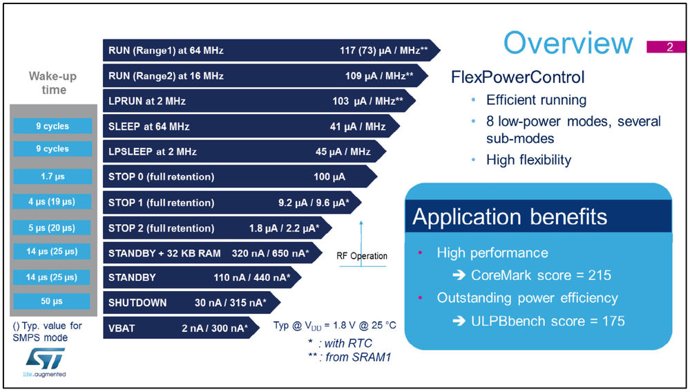

2023-08-02 10:26 AM
Then, I cannot understand what this slide means in range 2.
