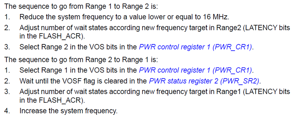

I'm trying to use Range 2 mode in my custom STM32WB55 board to reduce power consumption in my board.
I found the protocol that switchs Range 1 to Range 2 mode in RM0434 document.
The basic protocol is like below and I found that three register should be changed to use Range 2 mode, which is RCC clock control, Flash ACR, and PWR control register (+PWR status register).
So, my question is how to change these registers and is there any example for change these or CubeMX to help change these value?

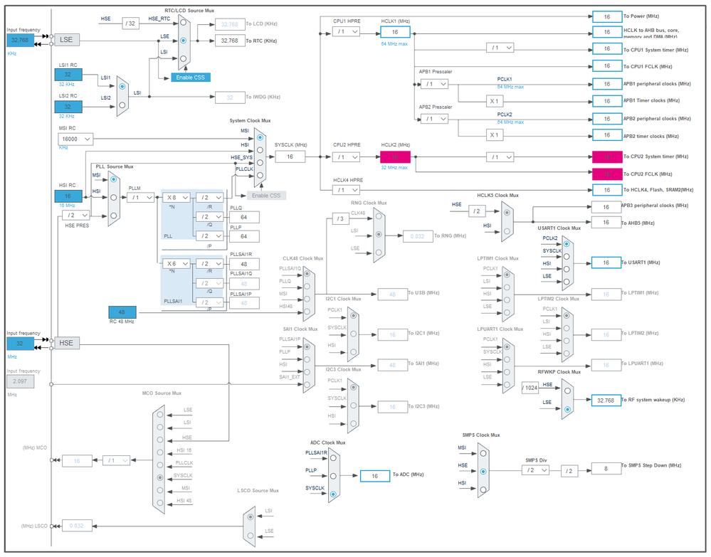

In addtion, I tried to change RCC clock using CubeMX but HCLK2 cannot be 16 MHz. Why?

2023-08-01 1:32 AM
Hello @KKIM.6 and welcome to ST Community.
go from Range 1 to Range 2 you have to:

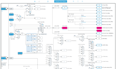

you can do this importing some modification on your code's source files.
For your second question, the answer is in screenshot below.

2023-08-01 7:35 AM
Still, my cubeMX shows error in HCLK2 in 16 MHz.

2023-08-01 8:06 AM
I found that the use of RCC caused the problem in HCLK2.
However, I cannot turn on RF if I do not use RCC.
What should I do?
or is it not mandatory to use HCLK2 in 16 MHz?
2023-08-01 8:26 AM
Hello again,
You have to keep your system frequency to 16MHz or lower. But if you go lower you need to check the Table 4 in the RM0434 to make sure about the wait states.
Can you add your RCC Mode and Configuration
Best Regards
Issam

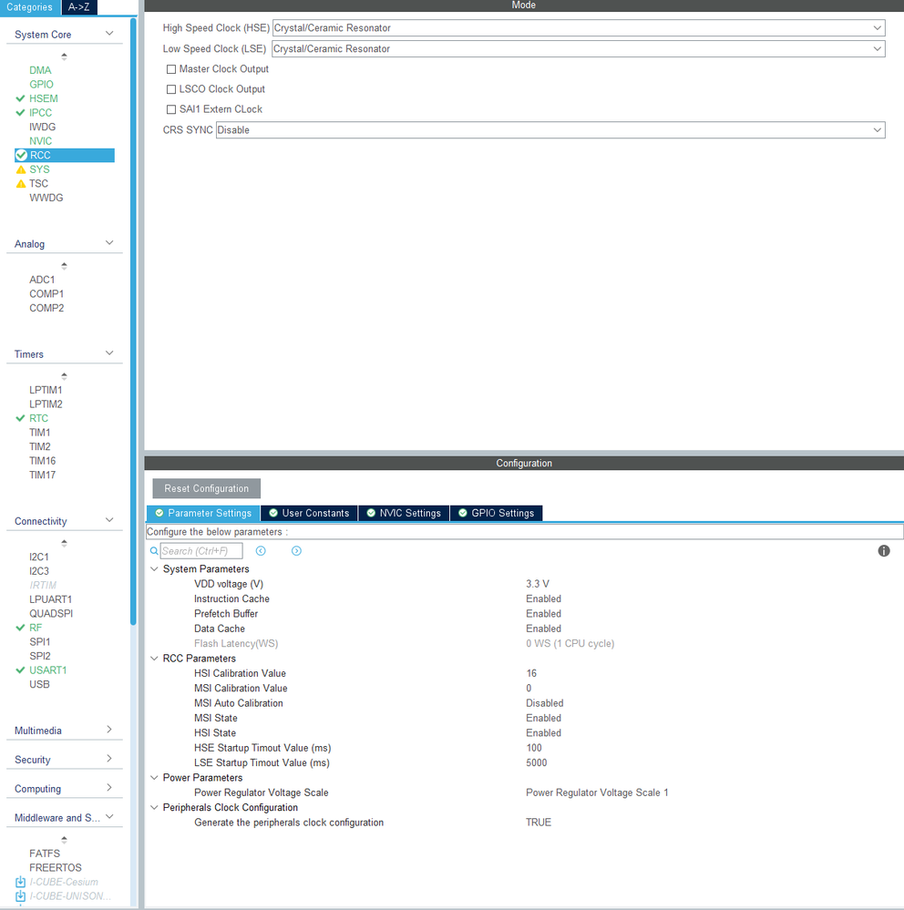

2023-08-01 11:49 AM
I upgraded CubeMX in the 6.9.1 version but still the problem doesn't be solved.
Here is my RCC configuration.
I created a new project and I'm changing each setup to find the reason.
2023-08-01 11:51 AM
The error disappear when RF is deactivated......OMG..
2023-08-02 7:51 AM - edited 2023-08-02 7:52 AM
Hello again
After verification, is impossible to use RF communication in Range 2. Sytem clock in Range 2 should be under 16MHz but in RF transmittion CPU2 CLOCK must be 32MHz. What means system clock should be 32MHz.
Best Regards.
Issam
2023-08-02 10:23 AM
That means....we cannot use BLE in range 2 mode...that's too bad.
