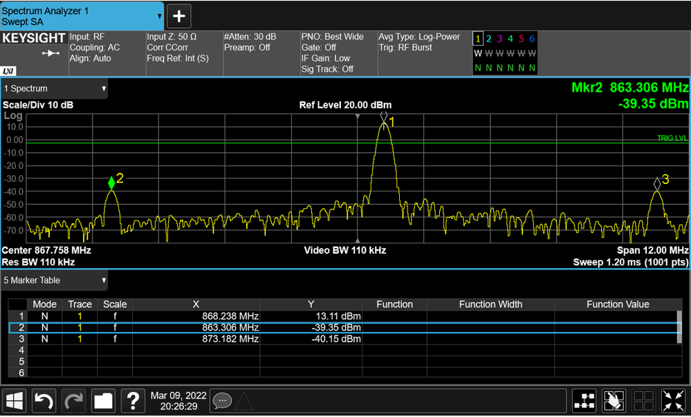

I have started to develop one LoRa end node around a STM32WLE5CC6 chipset(QFPN48).
My device is operating in EU868 band. While the device is transmitting, I acquire the data for the frequency spectrum with a spectrum analyzer. As you can see from the screenshot, there are unwanted sided-signals(spurious) around the central frequency(868 MHz). Specifically, both the lower side and the upper side are equally away 5 MHz from the central frequency.
What is your consideration for the possible root cause of spurious injection? Is there any way to block or reduce these spurious?

2022-04-12 10:53 PM
This spurious is part of SMPS problem. To fix the problem disable SMPS or change the components of SMPS with more optimized ones.
