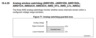

2024-02-02 7:02 AM
You can use ADC in watchdog mode:

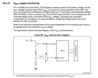

2024-02-02 6:35 AM
Measure the VBAT voltage on startup with the ADC and, if it was below the threshold, require that the RTC be reset.
2024-02-02 7:02 AM
2024-02-06 6:10 AM
Thanks for your answers.
I added reading VBat at CPU startup and resetting the RTC if necessary and it works very well.
