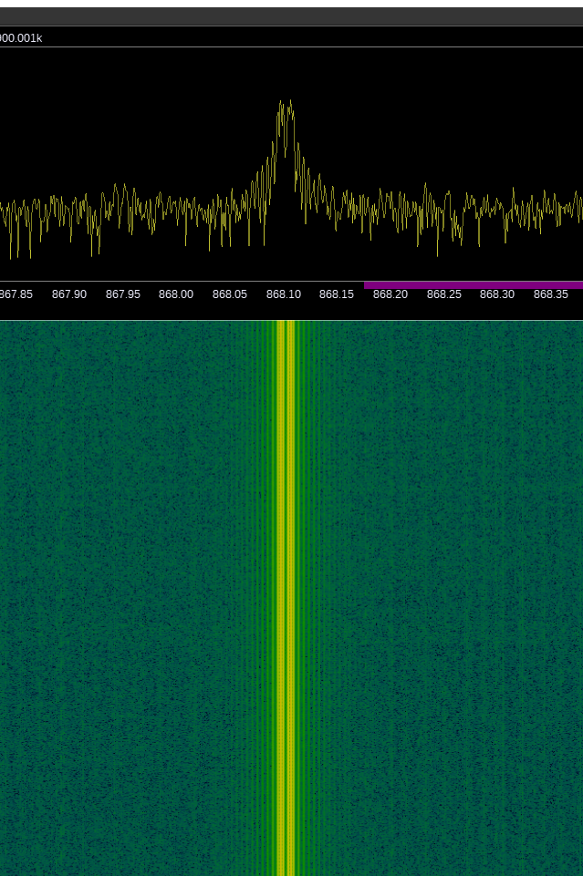

2022-12-04 8:27 AM
I have use a spectrometer and the RFM95 transmit juste the carry frequency. I don't see the chirp of the lora transmission
2022-12-04 11:44 AM
Perhaps subtle differences in the CS fall and raise with respect to the data. Watch for things like the FIFO and data clearing the wire.
