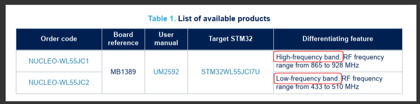

one for the High band (Nucleo-WL55jc1) and the other for the Low band (Nucleo-WL55jc2).
@Zayoud see your previous thread:

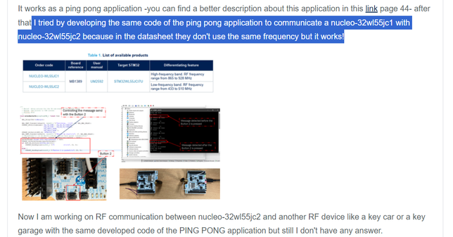

I tried to communicate the nucleo-32wl55jc1 with the nucleo-32wl55jc2 with the same configuration at frequency 315 MHz and it works!
I did this as an experience to know the difference between these two boards.

@Zayoud wrote:
- Build an auto-switching system to select between the high and the low frequency bands.
probably a key thing which sets the different bands is the hardware components on the board - inductors, capacitors, etc ...

Hello @Zayoud
In fact, the STM32WLJCx can work out of the defined frequency but we can't guarantee that it works or not and if it works, the accuracy still not guarantee. So, it will be a good idea to use each product on his frequency limits. For your project, you can still contact as for any request. "Marahba bik".
