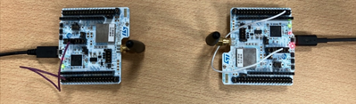

I am writing to request your support for a project involving the Nucleo-WL55JC. I have successfully communicated between two Nucleo boards using RF communication with the SUBGHZ protocol (not LoRa).

As I said, this is not the main topic of the thread, but these devices use RF to communicate:
Please assist me in the main topic:
