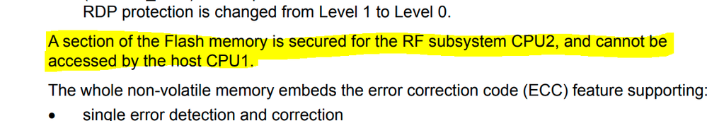

You're probably reading FLASH that is reserved for the second core (CPU2) handling the wireless functions.
From the datasheet:

2022-03-01 5:25 PM
0x0806f18c is near the end of the flash.
From the datasheet:
2022-03-01 5:26 PM
Read out FLASH_SFR to verify what's reserved for CPU2.

Makes sense. I missed that in the data sheet. Thank you.
