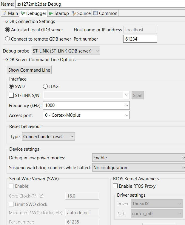

When debugger is enabled console output is the same, without the "Target is not responding, retrying..." part. Program just falls into HAL_PWR_EnterSLEEPMode() or HAL_PWR_EnterSTOPMode() fuction depending on low_power mode configuration. It stays there forever, which isn't an expected behaviour.
Here is a debugg configuration:
I ve spend quite a lot of time trying to find the solution and I ve run out of ideas so i will be realy greatefull for help.

Hey there, I've seen this error before and only way I know is to enable the debug.
Try to find \Core\Inc\sys_conf.h header file and set the following definitions as such.
DEBUGGER_ENABLED 1
LOW_POWER_DISABLE 1Have you tried this?
