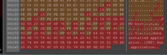

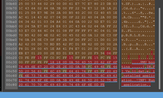

I have a similar problem with this snippet on my STM32L071CB... I use my flash and USART drivers, but the xmodem module from this snippet is similar in my project. I've tried Tera Term on Windows, tried `sx -kO` with screen or picocom on Linux (-O option disables all timeouts), and also a self-written python-script. Sometimes the 55Kb firmware is transferred successfully and the firmware is installed correctly, but in most cases after the 4th packet (3kb received successfully) all the utilities start sending some kind of garbage... I can't understand the reason why the PC utilities start sending something different from the protocol. This garbage is also not a part of the sending firmware
I am attaching the output of the logic analyzer. Red is what the STM32 sends, yellow is what the utility sends. Byte 0x06 - ACK, byte 0x15 - NAK via XMODEM protocol. The first byte in the packet must be 0x01 or 0x02, not 0xFF or anything.

I could say that it is interference on the USART line, but I don't think so. Absolutely always the problem occurs on the 4th packet
The USART baudrate is set to 115200

Seems highly improbable that multiple independent utilities would send junk.
Be aware that the STM32's typically stall real-time execution when writing/erasing flash, this will break interrupts and peripheral service.
The ACK should only be sent after the packet has been checksummed AND written to flash memory, so it acts properly in terms of controlling flow. If the USART is managed/buffered under interrupt, or the flash operations differed into another thread, you're likely to get headaches.
Instrument so you can understand dynamic flow without using a debugger, which will further interfere with the operation of the core, can be invasive.

Thank you for your response!
My USART and FLASH routines are blocking, I don't work with interrupts in this case.
I don't understand why STM32 is to blame. The output in the screenshots is from a logic analyzer, so this is exactly what is happening on the USART bus. The screenshot shows that as soon as the STM32 sends an ACK, the utility sends 0xFF, 0xFC, and so on, which should not happen via the XMODEM-1k protocol. And the USART of the microcontroller should not be to blame here.
The XModem in this snippet is implemented so that a 'C' byte is sent when the firmware is run, until the PC utility starts sending packets. Next, the first byte is checked: if it is 0x00 (SOH) or 0x01 (STX), then the entire packet is received depending on the length - 128 or 1024 bytes, after that the CRC-16 of the packet is calculated, the packet number and CRC are checked and then Flash programming is performed. If this is the first packet, then the STM32 is erased before programming. After completing operations with Flash, the microcontroller sends an ACK and so on until the EOT byte is received. In case of errors, 5 attempts are allowed (NACK is sent), after which the transaction ends with CAN abortion
