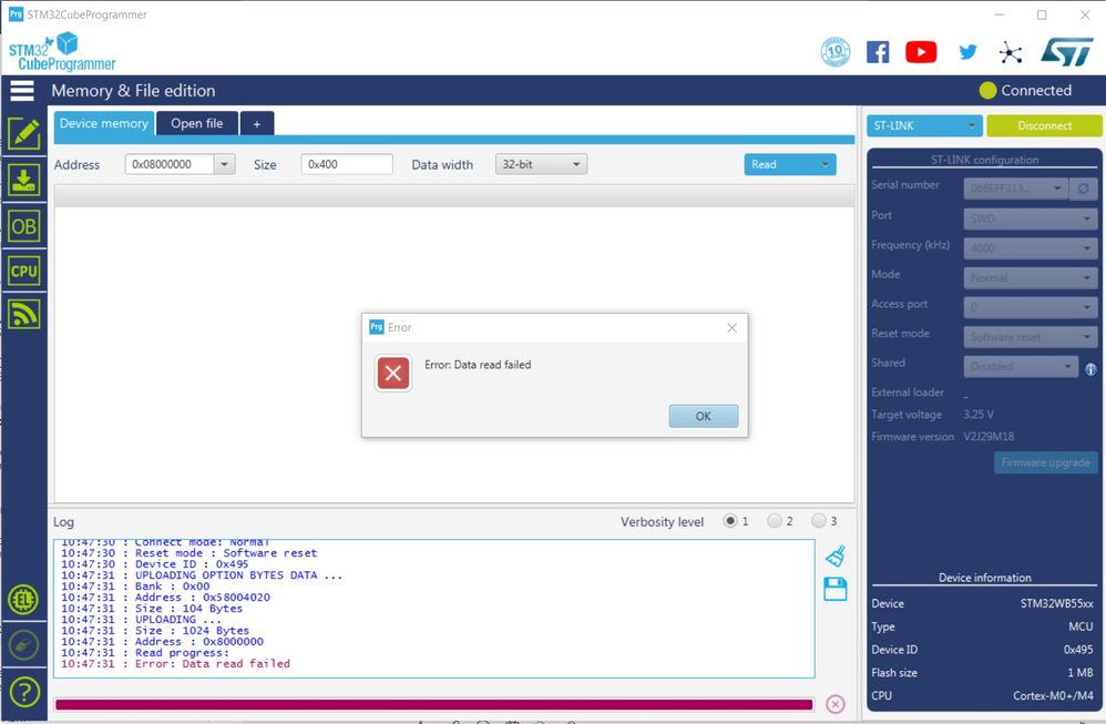

STM32 Cube Programmer Utility :
Snapshot of Error STM32 Cube Programmer : Connect event

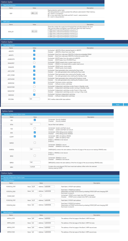

I am able to read option bytes:

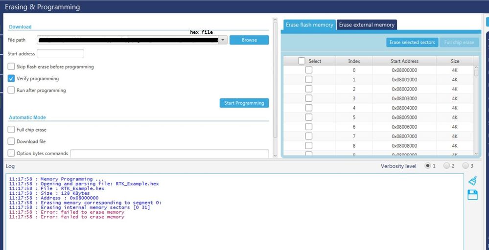

But I am not able to erase or download

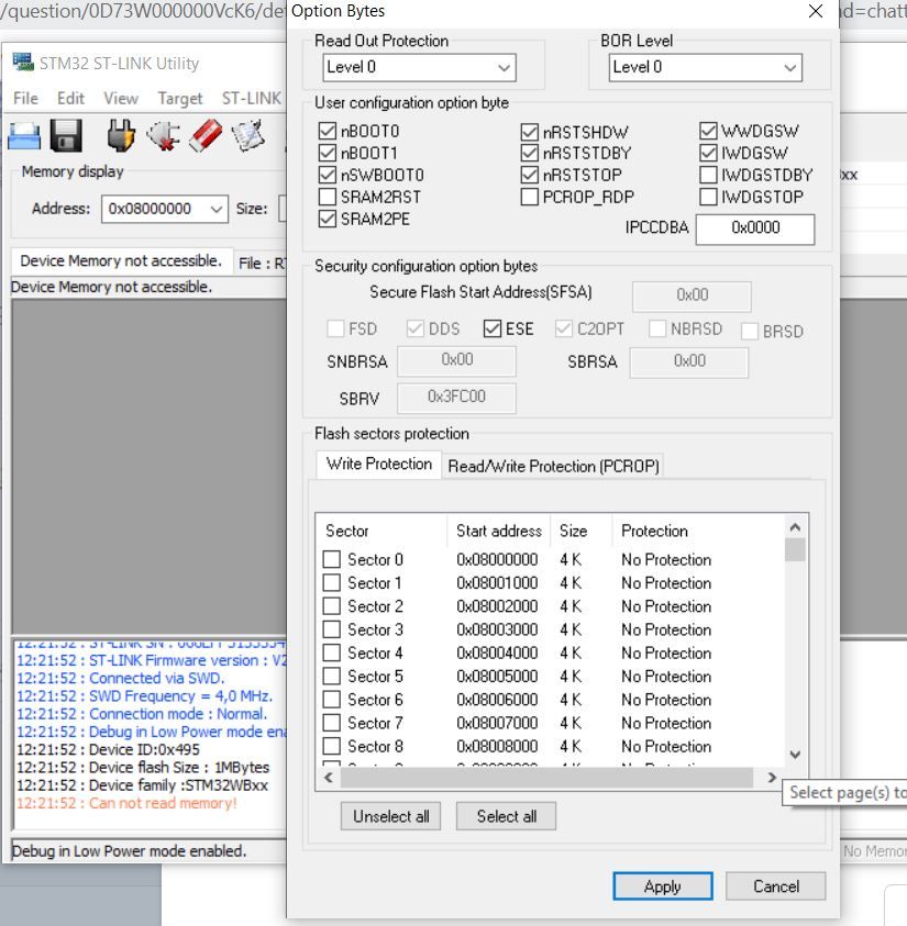

STLink Utility :

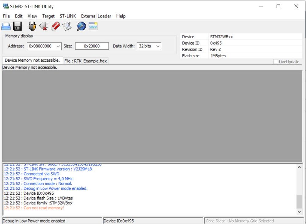

Able to connect but getting read error :
I am able to read option bytes :

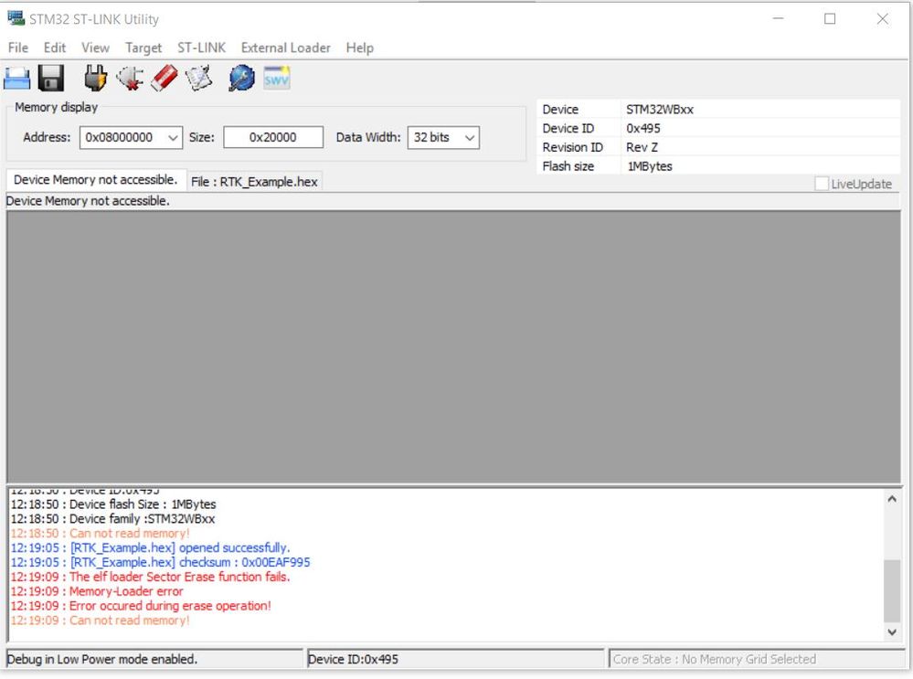

Error in erase and download :
