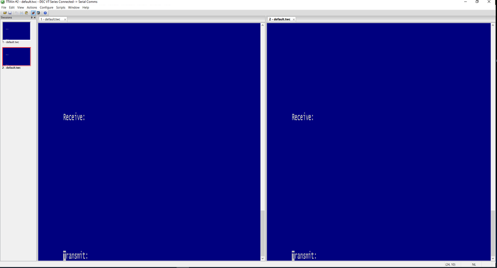

Open VT100 Terminals on Client and Server side. Connected to ST Link COM port @115200.No idea of what VT100 terminal is, im trying to use putty and realTerm, is that ok? it wasnt

*2* Client ----------- Wtite Command packet ------> ServerWhat it actually happens is this
I type ascii "u" and the stlink answers with a weird string (nothing happens in the other module)
Ok i realised VT100 is not just a name of a serial terminal programm, this is a whole different ancient uart protocol yeey (its defined in octal)
So more reverse engineering, im starting to believe this is not going to be a very usefull example
So if i send the character "t"
i would get replied "\e[32;23Ht" which kind of looks like
https://vt100.net/docs/vt100-ug/chapter3.html
"e[" would be equivalent to "ESC[" (CSI)
the last H would be
Final character
A character whose bit combination terminates an escape or control sequence.
The parameter string has two parameters and they get build inside this function
void PosCur(uint8_t iX, uint8_t iY)
char szCtrl[30] = "\33[01;01H";
szCtrl[3] = (int8_t) ((iY % 10) + '0');
szCtrl[2] = (int8_t) ((iY / 10) + '0');
szCtrl[6] = (int8_t) ((iX % 10) + '0');
szCtrl[5] = (int8_t) ((iX / 10) + '0');
UartTransmitStr(szCtrl);
}Now i just need to find a working windows vt100 emulator
30days free trial this should do for now

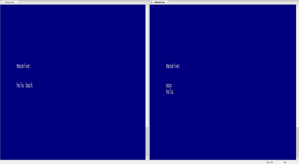

2021-09-22 1:34 AM
Now im able to undestand what are the com ports echoing back to me
Next step, guetting rid of all that VT100 layer,
i want a plain happy uart bridge whih is what the example should have been in the first place
