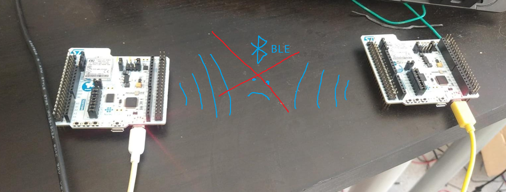

Hello im trying to establish communication between two P-Nucleo_wb55 boards.
Once i flash the firmware with cubeIDE example
(\STM32Cube\Repository\STM32Cube_FW_WB_V1.12.1\Projects\P-NUCLEO-WB55.Nucleo\Applications\BLE\BLE_CableReplacement)
#define GATT_CLIENT 0//1//chaning this for client/server rolesI open serial terminals on my PC (putty or realterm), COM ports are visible but they are unresponsive....
I have no idea of where to start debugging

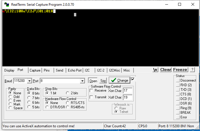

Open VT100 Terminals on Client and Server side. Connected to ST Link COM port @115200.No idea of what VT100 terminal is, im trying to use putty and realTerm, is that ok? it wasnt

I type ascii "u" and the stlink answers with a weird string (nothing happens in the other module)

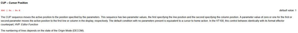

Ok i realised VT100 is not just a name of a serial terminal programm, this is a whole different ancient uart protocol yeey (its defined in octal)
So more reverse engineering, im starting to believe this is not going to be a very usefull example
So if i send the character "t"
i would get replied "\e[32;23Ht" which kind of looks like
https://vt100.net/docs/vt100-ug/chapter3.html
"e[" would be equivalent to "ESC[" (CSI)
the last H would be
Final character
A character whose bit combination terminates an escape or control sequence.
The parameter string has two parameters and they get build inside this function
void PosCur(uint8_t iX, uint8_t iY)
char szCtrl[30] = "\33[01;01H";
szCtrl[3] = (int8_t) ((iY % 10) + '0');
szCtrl[2] = (int8_t) ((iY / 10) + '0');
szCtrl[6] = (int8_t) ((iX % 10) + '0');
szCtrl[5] = (int8_t) ((iX / 10) + '0');
UartTransmitStr(szCtrl);
}Now i just need to find a working windows vt100 emulator

Your picture shows 2 Nucleo boards.
The elearning “WB Bluetooth mesh - 7 Lab 1: Creating Bluetooth Low Energy project STM32WBMMG-DK�? is based on a Discovery board (DK) and not Nucleo. Cable replacement project is a pure BLE project while this elearning is based on the mesh specifications which is only based on BLE advertisement packets.
In the end, I understand you think you corrupted the FW stack loaded on the M0+ core. You can reload it with CubeProgrammer. Please be sure to have the latest V1.2.0 FUS version loaded on your board before any stack upgrade.
When you are connected, have a look at the SFSA option byte which should be 0xCA for the BLE stack with the WB FW package V1.12.x version.
You can activate IPCC with CubeMX. Have a look at the attached picture.
