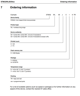

For the STM32WL55, they are MCU (Microcontrollers). you can find all explanation about the naming on the part 7 of the datasheet:

6 / 7 relates to temperature, and IS in the datasheet
https://www.st.com/resource/en/datasheet/stm32wl55cc.pdf#page=147

Thank you for the confusion RE 6 and 7
