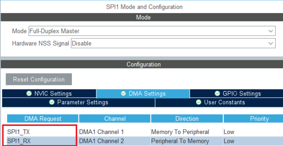

Hello @NRoss ,
The BSP_ERROR_FEATURE_NOT_SUPPORTED can be removed by applying the right settings in SPI1 config.
I see that you used SPI1 interface for ILI9341, so you need to navigate to SPI1 configuration and enable both TX and RX DMA requests.
By re-generating the code, you will get the following lines in lcd_conf.h file.
#define LCD_SPI_Send_DMA BSP_SPI1_Send_DMA
#define LCD_SPI_Recv_DMA BSP_SPI1_Recv_DMA
#define LCD_SPI_SendRecv_DMA BSP_SPI1_SendRecv_DMAI hope this helps :smiling_face_with_smiling_eyes:
